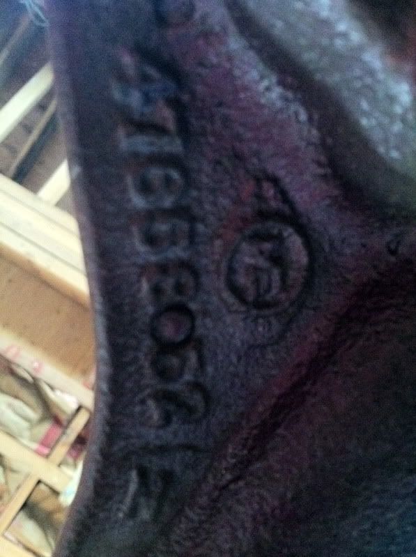

got this bike a few weeks ago,
has a 60xlch motor in it
just trying to find out possibly what year this frame is and if its worth anything
I want to build a rigid frame sporty and if this is an early frame that matches this motor I might just hang on to it and stash it for later on
thanks for any help

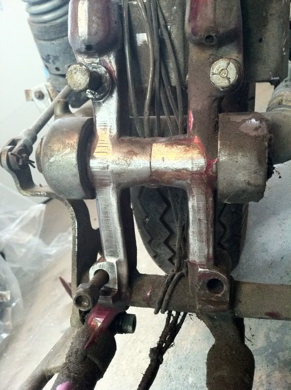

these are from under the seat casting
this is what the bike looked like when I picked it up
431 Posts
It's an early XLCH frame, but someone did you a favor and cut the seat mount off it and lost the date code in the process. If it is the original frame, you'll never know now. As cut as it is, I wouldn't feel too bad about hardtailing it. Once you lose the date code it'll never be match-able again. It's a shame, 'cause it don't look too hacked up otherwise.

There should be a stamped number by the top motor mount and maybe where the seat mount used to be, will be some thing like A4 and so forth, it is the right frame for the year, modifide and not stock any more so it is up to you if ya want to hardtail it.......Roach.

whether its the actual frame from factory that was with that motor, or not doesnt matter. to my knowledge sportsters pre 70 didnt have title numbers on the frame, titled by the motor numbers, and your frame certainly looks like a 60 frame would.
