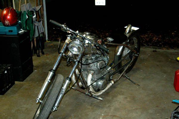

Discussion Starter · #5 ·
now i really see what you are talking about!! and that is one righteous looking ride man!
chopsnbobbers said:
yeap you got it, by using tube you can get a tighter bend without the cable getting tight. I did it on the throttle cables for my Trump
http://www.jockeyjournal.com/forum/showthread.php?t=2013
pic #5 shows the 2 tubes coming from the twist grip
