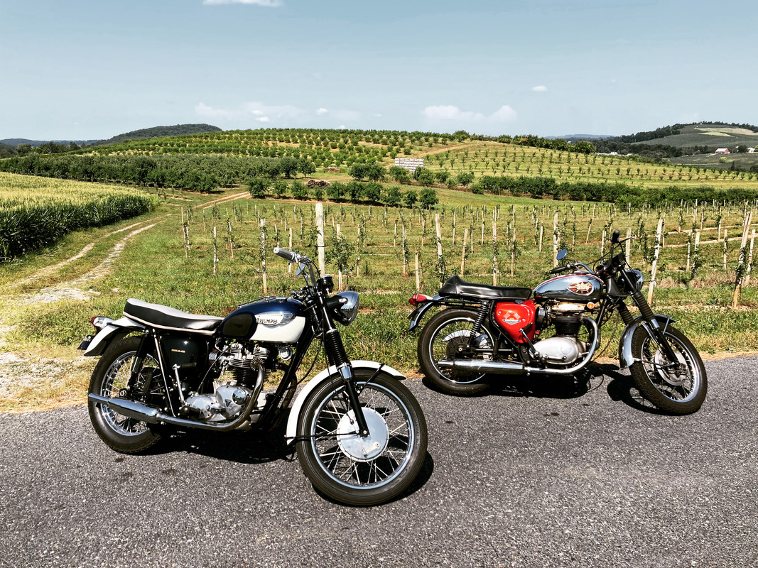

Can,t beat a old sidevalve Beeza for reliabilty, had them for years just sold my 41 WM20 after 18years of ownership, but I gotta a 48 M21 last year of girder/rigids to replace it. Your has the makings of a nice machine but looks like it has had it far share of bodges.. them forks need serious attention, I would make a jig then chop out the rear tubes clean up the castings and fit new rear tubes with slugs into the castings and sweat braze them together.Your gearbox is loose because the large washers on lower fixings are missing, good news is you have the best clutch you can fit to a M20/21 I have had these fitted to all my beeza sidevalves fit & forget.You gonna rebuild it to ex WD spec ? .These bikes can be geared up with more teeth on engine sprocket my old WM20 ran a 21 tooth sprocket and would sit at 60-65 mph all day even fully loaded..see photo
My current YM21

Wow Those are nice TribsaUK !!! I dream mine will look that good... Yes I will make it look as close to 1943 war spec as money will allow. Ive already spent more then the bike might be worth and its not together or running yet :eek:
