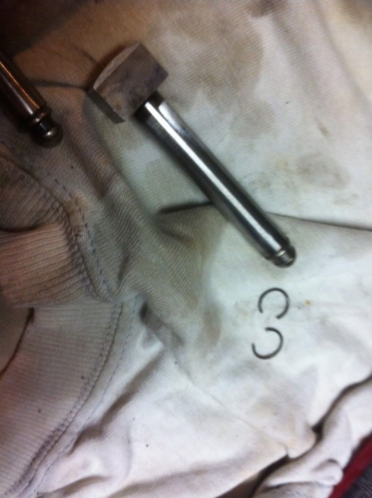

Does any one know a good way to install these clips onto the tappets of a BSA A65 motor? Should you squash them down so they are a tight fit? From what I have found out so far is they get installed after the tappets are installed into bottom of the jug. There is also a tool to assist you but I am not 100% sure how it is to work,

I've rebuilt countless A series engines over the years and and never use them. Just liberally grease the tappets to keep them from falling out when you're ready to install the jugs...however since you have them, just push them down over the tappet shaft with a suitable piece of steel or copper tubing...the fit isn't all that critical, the only thing they do is keep the tappets from dropping out when fitting the cylinders.

I get it....that all they do is keep the tappets in while assembling the top end. But when this scoot gets a new owner and the motor gets done again....well I can just hear the dude bitchin' bout no circlips!
