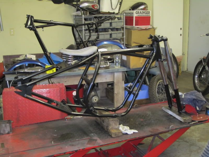

here is is 9 days until the the willies old school chopper show and we are just beginning final assembly today. its a 1965 a65 bsa with a 1970 big stud engine. 4 inch stretch 2 inch drop. i wish i had pics of mock up and fab work, but i will be posting pics frequently over the next few days of building.

The hardtail was mated to the frame in a jig at The Factory Metal Works shop, so it is very straight. Jimmy fabricated the fender/mounts to the tail section, shimmed the rear wheel to align the chain run, and then built the rear wheel with the correct offset so that the center line of the tire would line up with the rib of the fender.

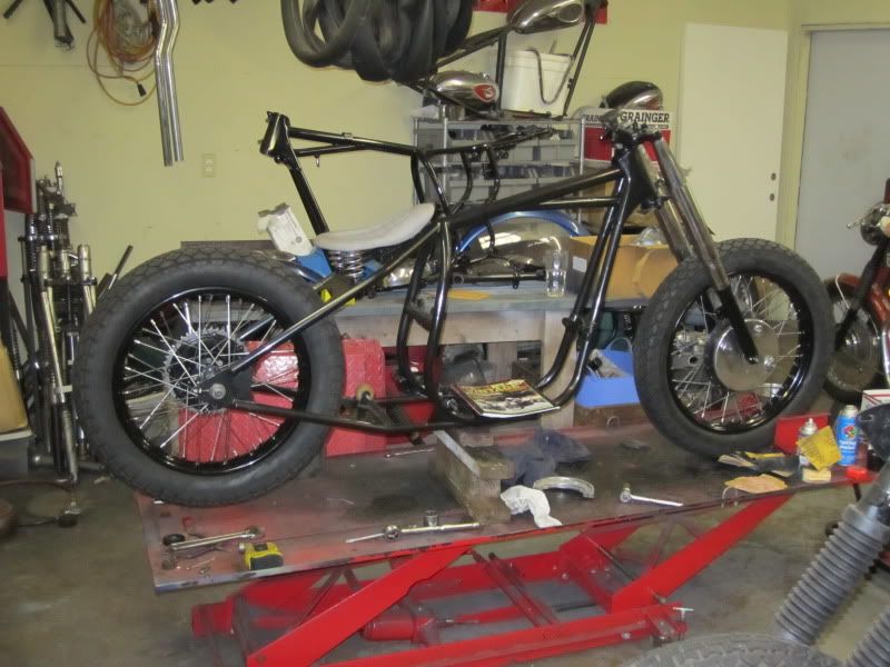

The forks are stock BSA as is the front wheel. That front fork / wheel combination began in the 1940`s, and was used thru 1968. The shrouds are vintage Wassell, after market parts made in England in the 60`s.
