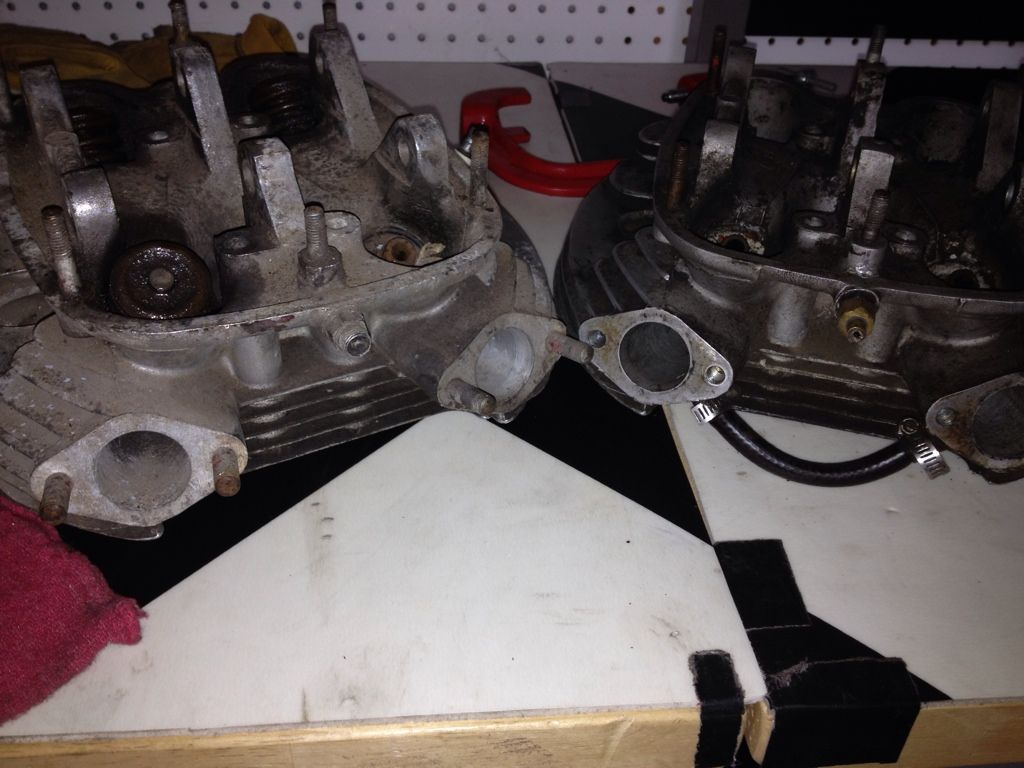

Picked this up at the mt Vernon swap meet yesterday. It has the smaller bolt sizes for the headbolts and the early casting marks. I has a good amount of meat on it for a resurface, but it does not have the hose between the carbs. Here is a side by side comparison. Any ideas?

I was thinking the same thing on the age. I am not sure the benifits of putting the piping in, maybe for easier syncing of the carbs. There was a obscure reference to generating more power without the older heads. I am unsure if there is any truth to that.

The balance tube was a new feature for model year 1966. It does help with street tunability, not sure about WFO horsepower. The '66 also got a new larger intake valve, definitely a plus in the HP dept.
