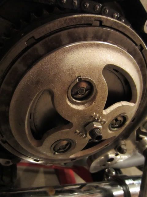

Starting to wonder if the clutch hub springs are too tight?? This is where I set them up at..
Any ideas ?
Any ideas ?
