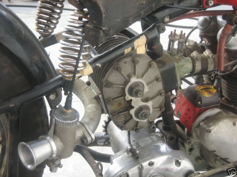

hey, I was thinking, cause I've got a blower like this - solves intake port flow problems ,what boost do you think you can run ? add methanol up to 20% with petrol and acetone
Hey Triumphrules,
Very interesting, does this bike have a thread somewhere. Would love to have some more info on it. Got a basket Thunderbird I am trying to find a direction for. BLOWER just blew me a way. What blower is that? Cute little thing. What type of performance gains are you having?
Maybe you could start a thread so Dan Boys tread isn't high jacked.
Thanks
Lester
Lester, that's not my bike - I found the pic just recently. here's mine- kb200 made in England - I was told it was a Detroit 3/71 or 3/53
