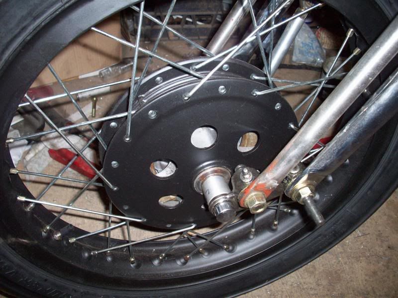

Here are both sides of a CB350 hub laced to an XS650 18" aluminum rim (36 spoke) using stock Yamaha spokes. Holes are optional. The arms and hardware are missing, as they were crusty and I was looking for better stuff. No comments on the f'd up stay arm, please.
