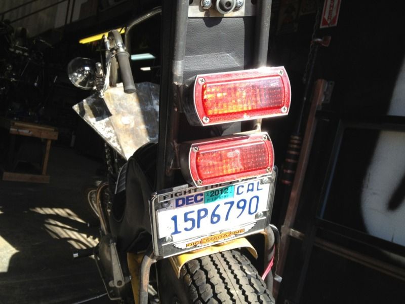

Long story short... I was at a Bikini Bar one night and I rode there on my '59 Triumph. An old dude comes in looking for the owner of my bike. He has a '68 BSA Lightning chopper that doesn't run. He asked how much I'd charge to get it running. I told him I don't do that for people, but I'd buy it.
I traded him a Honda generator and gave him $500 cash and this thing was mine.
Cleaned out the crappy Chinese carbs and got it to run. But the bike was starving for fuel at speed, so I went to see Torch for some good condish used 930's.
Here it is as I got it.
Ditched the Mustang tank and used a prism tank I had in my hoarder storage.
Stripped down a King and Queen seat that needed love. Had it done up in all leather.
Made a sissy bar out of solid round stock. Placed 2 Knight lights on it for the ultimate in tail lighting...
Welded tabs on some killer bars so they would mate with the springer.
I need to sort out a better oil tank and headlight. Then blow it apart for paint.

pretty cool so far but those mounting tabs on the bars are gonna get ya killed. try this, sit on the bike and violently jerk the bars back and forth and side to side like you were trying to rip them off the bike. if they don't bend or break then you're good to go.
They're super solid. I know it seems like a sketchy concept, but they'll hold.
