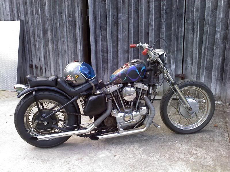

I have this ironhead I bought cheap and I am going to redo it. I threw the tank and stuff on for last summer and it's cool the way it is but I have some creative ideas for it. I was hoping they'd be some pix of people that took a bolt on hardtail and welded and smoothed it out. Let's see them

ok I started yesterday.
First I took the seat and crap off to expose the hideousness
Then I took a rough measurement and made sure I added to it so my tubes would be plenty long
Then I ued an angle finder on my shovel frame to get the bend I wanted
Then I cut 2 30" pieces of 1" DOM tubing and drilled and tapped my welding table to make the jig.
Then I slowly heated and bent the tubes.
That's pretty much where I'm at now.
