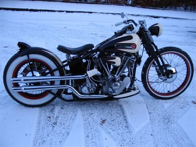

My buddy built it here in Belgium about 4 years ago... '79 swingarm frame with Santee weld-on rear section.. repop springer & front drum, K-model seat,etc.. I think I have a few more pics somewhere..
Any particular details you want to know/see..?

sick bike... what brand of mufflers are those
The cheap ones (Sold by V-Twin), not the Paughco types..
Head pipes are Paughco though..
The aluminium oil filter mount is a Sputhe wich I had laying around for years.. I gave it to my buddy as a birthday present.. (It was designed to use on the early Evo bottoms when they still had the filter mount on the frame instead of the engine case, he adapted it for the shovel case with a bracket.. now it "covers" that open gap when using the front early shovel type headpipe on a cone shovel..)
