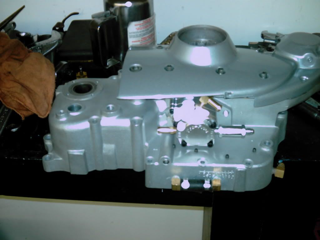

An idea on a up-grade oil pump...If you was in mind of doing so.
This pump is kick-ass for the 77-up Sporty
Has two sets of return gears....One for the sump, and one for the cam chest.
On the stock case there is a drain hole from the cam chest to the flywheels
This would be blocked off...Less oil for the flywheels to contend with..
They also make a three stage (On the return) for let's go racing...
Stock works very well on a Street driven Bike.
I run the stock 77-up Sporty pump gears on my 52 Pan-Shovel...
A big time up-grade from the spur gears of 52.

Hey drag does that oil pump come in one for a 75 sporty and does a 75 need to be timmed?
Hey drag does that oil pump come in one for a 75 sporty?
Not the one in the picture....That is for 77 and up Geo-Roto gear (Gear inside a gear) design.
For All Sportie's from the K's to 76...You can get a Billet pump...They have the larger pump gears as in the 72-76 OEM pumps...
Would be a good upgrade to do to the 71 and back bikes.
