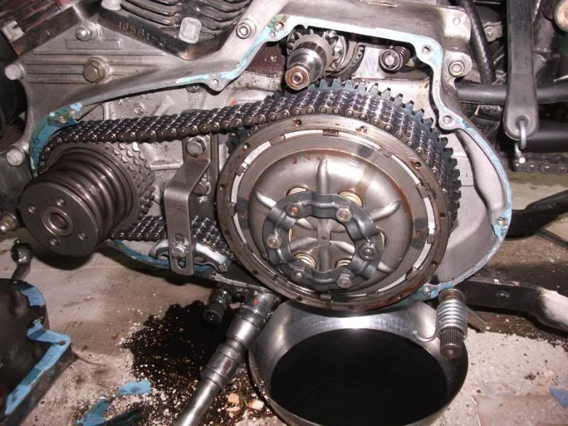

Already changed the starter and solenoid with a set I know worked. Still not working for s**t. Gears look fine and battery has full charge when I start hitting the button. Been collecting kicker parts when I find them but still going to be some time before I can get them all together.
Question is, with the primary cover off can I bump it to see what's going on in there? Without the support of the cover? Or would it be a disaster?

I would say disaster. If you have a old primary cut it up as to have a support for the bendix gear. I know that sounds pricey but if that bendix jumps out when you hit the button could crack case or if your fingers are in the way it would eat them. You could cut it and use the top 4 bolts to hold it in place. Maybe you could build something that could support that bendix. Good luck.

It throws but will only engage the gears to turn the engine about 1 in 30 times. Wires are all good, some replaced. Everything looks good.
Happened to me. The 'Bendix' is shot:

THe gear rarely goes bad, unless you have a bad ring gear. The bendix, has internal parts that fail, way before you can wear out the gear itself. Even when you check it in your hand, it may work perfectly, but your hand is not 9 to 1 compression, times two. They are only about 25 dollars, and even if it is not bad, you have a new one to rely on for a while. If you push the button, with the primary cover off, it could cause problems. You may do it a few times with no problem, but if it hits the ring gear at the wrong spot on the flats, it could bend the shaft on the drive, or break the starter bolts off, or the case. So beware of doing that with no support bearing to keep the shaft straight in line with the ring gear. If you need kick starter parts, I have some used stuff laying around. Drop me a pm and let me know what you need. Hate to see you miss the run. Or if you got a hot old lady who has big milkers, send her out here, and I will return her, slightly used, with a brand new kicker set. haha (serious about the used parts, no OL necessary)
