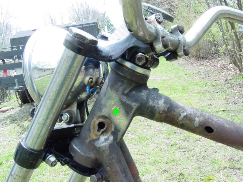

pics
desert sled, ceriani front end (I think)
the s/n 021939 is on the engine and the frame on the left side of the neck.
the other # F4610 B is on the right side of the neck.
what is it ?? :confused:
It is not a '59 as the duplex frame didn't happen until '60 and that one appears to have the upper brace so it is '61 or '62. It is a TR6 trophy 650, no 500 engines were pre unit at that time, they had all become unit by then.
Definitely set up as a desrt sled. Due to the common practice of blowing stuff up and just re-stamping another engine to match the frame on race bikes it has been done like that. Who knows for sure what the engine is. That number you show on the frame is a casting number and is on all of them so it means nothing except that the neck casting is for a late duplex frame. The alternator primaries are also correct for a late pre-unit as the generator ceased to be by then and your case have no provision for one. A '59 would have had one.

Being a race bike, the odds of the engine being original to the frame are smaller. The engine may even be built from pieces of different motors. The cases are alternator cases. (5T '55-'58, 6T '54-'62, T110 '60-61, TR6 or T120 '60-'62) If you've got the right books you can tell more by the casting numbers. The stamped number, however, is not original to that engine's left case half.
The frame's serial number should be stamped in the left side of the neck and be either 029364-030424 or D101-D25000 (or thereabouts. I don't know the final duplex frame number so that's a guess based on previous years production) Your number is a '59 number, but may have been stamped into that late '60-'62 frame to match a '59 title that someone had long ago. It was a common practice back when, both for race bikes that kept blowing parts and bending frames, and unfortunately for stolen bikes. It's a nice bunch of parts you've got there though. Find yourself a titled pre unit frame and a clean set of cases and build a bike. Or alternatively, you could part that bike out and scrap the badly numbered pieces.
Here's a pic of what a duplex frame serial number should look like.

It would be best to title it as a '61 or '62 as none of those frames existed until then. Are you sure there is no frame number?
What is the transmission number? It is on top behind that clutch arm.

He said it's got 021939 on the neck, Robbie. Pics might help...
Yes, the s/n 021939 on the engine is also on the frame.
