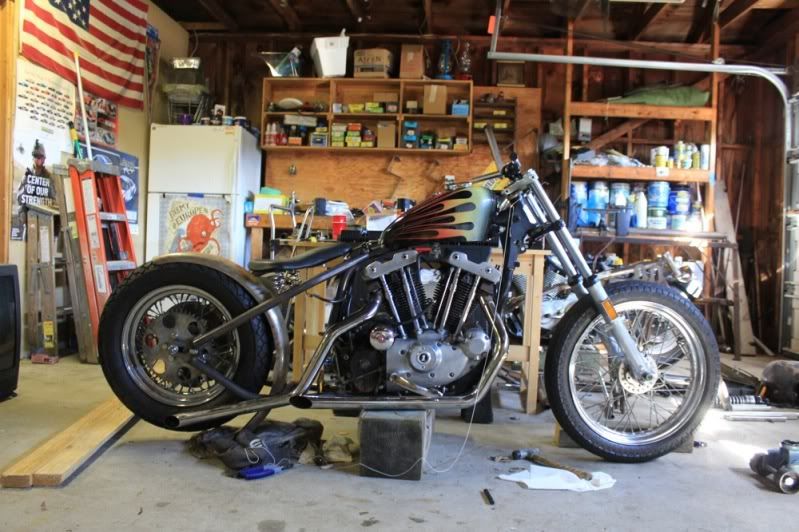

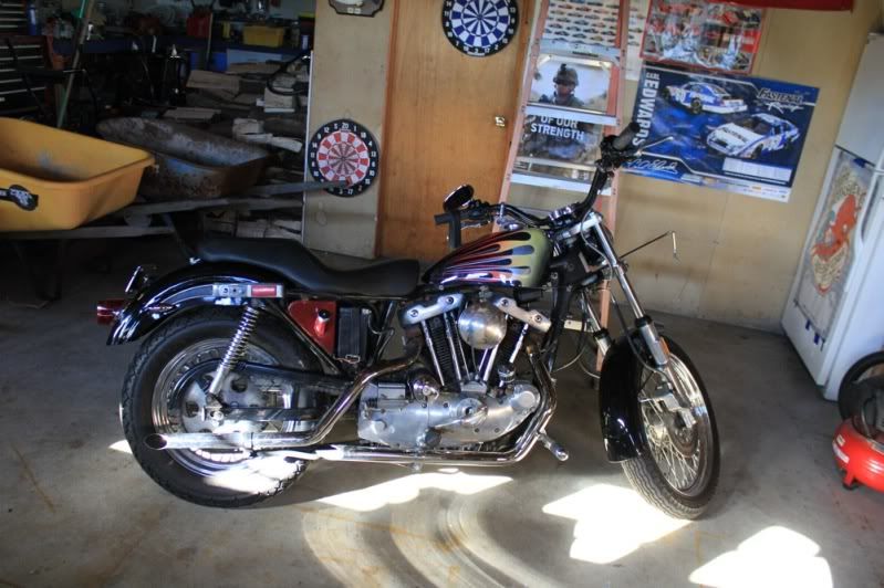

so i bought this bike last december as a first bike. by the time march rolled around i wanted to hardtail it. and i thought i could get it done in time for the summer! boy was i naive.
heres how it stood when i got it.
and after ordering a hardtail i got a friend to weld it on. after it was welded i realized the engine was just not gonna fit. after trying a few different things the engine just would fit it. so i called the maker of the hardtail and he had me send my frame back to him because he thought he knew where he messed up. and he would weld it on. after i got it back i had the same exact problem. after trying again to make it fit i realized i couldnt do it on my own. i called the guy and he said he didnt know what to say. so i brought it to a local guy. some of you may know him dave a.k.a tigman and he figured out the problem all the while pointing out the other flaws in the frame. frustrating experience but. heres how she stands now

im in the process of figuring out spacers for my rear wheel. i realized my caliper bracket may be too thick so i had it milled down so i could space it better.
heres how it looks

looks to me like that hardtail was for 78' and earlier sporty frames. 79's were different in the seat casting area and used a different weld on. I think the one I used on my 79 was made by santee, but they only offered one that fit in a wide tire application. The rear area looked kinda silly being that wide with me only running a 130 in there. Glad to hear a member here got you fixed up.
