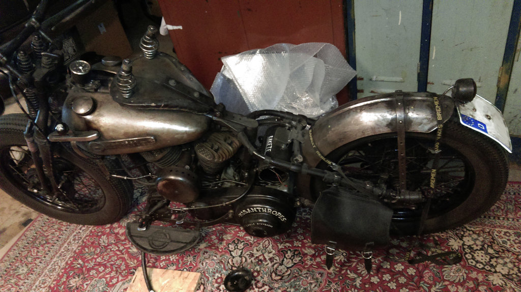

I thought i'd summarize my first build here for everyone who's interested.
Unfortunately i must have done something wrong and the computer killed everything
i typed for the last 20mins.
So i start over, and this time i try short posts.
*cough*
Sooo, i decided to get a new project 2 years ago and i wanted it to be two-wheeld this time.
I got onto everyone's nerves here for quite some time and then found something of interest. I didn't think too long because i knew i'd buy it anyway, and bought it.
Here's what i got:

small update...
i tinkered with some exhaust ideas and built a WR style turnout.
quite loud... so nothing for long trips and neither for inner city traffic,
to be honest. too much attention by the wrong people when you wait hours
for the lights to turn green...
otherwise it works fine. ;)
afterwards i thought i'd build another one and came up with this,
basically the whole thing was just for practicing my welding...
but i kind of like it and i think i'll run it like this for some time.
i'll have to do a lot more excercise on welding pipes,
but it was fun and i'd like to build a dual exhaust
with the rear pipe crossing over under the trans
to run a second fishtail maybe. let's see what spring brings... :)
7
got some work done on the bike over the winter.
since i had some troubles with the primary and the clutch over the last years
i decided to go for a belt drive.
before i did the conversion i tore the tranny apart to check the wear and
put some fresh bushings in i skipped the last time (around 15000km ago)...
shift lever bushings...
reassembled...
back in the frame, got my old inner primary cover from the shelf
and put it back in for belt protection.

prepared for mounting the new clutch and belt drive.
it's an HMB system, extremely well machined, very light and hi-tech
(and extremely out of place on my machine, harrharr...)
but it will be fully concealed in the end, so function over beauty here.
put things in place...
all worked like a charm.
now for some serious cleaning of the primary cover.
put spacers under the service lids to allow some breathing.
aaaaaand in the end you can't see a thing :)
so hopefully i'll be back on the road soon after some more service work,
adjust neck bearing, service wheel bearings, things like that.
in last november or december the bike got a nice little spread in
a small german magazine called "Kustom Life Magazine" i thought i'd share here:
now back to wrenching :)

haven't updated this in quite a while, so here goes.
i moved the linkage closer to the pedal pivot as suggested and it works
a lot better with that setup.
i added a miniature switch for the hi-beam (finally)
then the kicker gear exploded and the whole thing spiralled
into a never-ending series of tranny surgery desasters
(i rebuilt the darn thing several times now) over the whole 2018...
i proved that it is possible to rebuilt a 3 speed in frame!
(don't ask me why i had to prove that :rolleyes:)
completely senseless, haha... but it's possible.
still managed to have some fun, though!
but then it bit me again :mad:
i noticed there were different style kicker gears over the years...
i ended up using the original part that i had swapped out years ago and for now it is in stable condition
the HMB clutch and belt conversion is absolutely awesome,
it works super smooth and since everything is well covered it still
looks like new in there. completely different bike with the swap.
it bites the eye, though, together with the rest of the bike,
so the cover has another good reason to be on there!
also i bought a brand new gear box (4speed in a 3speed housing)
and put it on the shelf as a permanent threat to the old tranny.
latest addition to the ensemble is a super neat Bates pad that i was yearning for for several years now...
always had to buy things that were more important, but now i finally got one.
it rewinds the clock and suddenly it's late 40s to early 50s again :)
the weather is sweet and i already put miles on her. happiness.
thanks guys.
unfortunately, this tuesday the little bitch just fucked me again and the old oem
kicker gear once again started skipping teeth so i can't kick her over properly anymore.
soooo...
stay tuned for the upcoming 4 speed swap, it's going to happen very soon.
i really hope that Samwell box does the job.
:mad:
