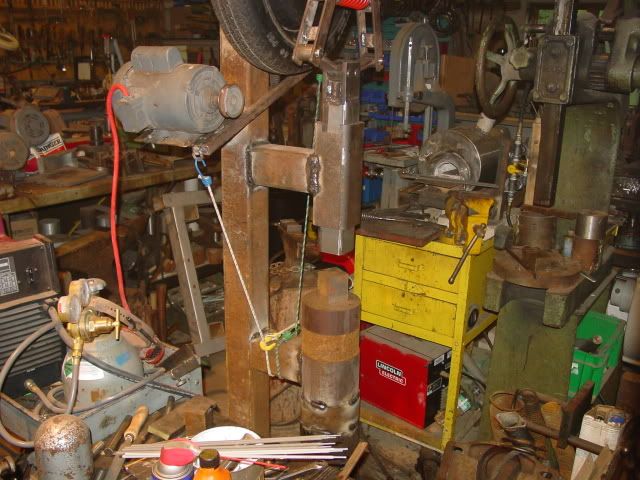

adjust the adjuster so that the lower bearing assembly barely cleares the upper and align it as good as you can,
then spot weld the lower bearing mount to the adjuster
and remowe the bearings,use a scrap piece cut to 25mm to make sure the lower brackets stay in place,weld solid,and grind to desired finnish,now you can measure the upper bearing for the grooves
and machine them
desmantle and paint and refit all components
it shoul look something like this (maybe better)

it might look like it need stiffening but it's sturdy enough to make beaad marks in 1mm steel and then your applying to much force anyway,hope you like it and build your own version and post the result,maybe it will look alot better than mine so we all can learn more
//janne

Have a question. How good a fit do you need between the 32x32 bar and the 40x40x4 tube that it slides into, and how do you get the inside weld seam out of the 40x40? I've taken the seam out of square tube before, but it was a bitch.

i have a wery complex way of dealing with that,,,,,,,, just kidding i use a 2,2 mm or similar cutting disc and make a groove in the 32x32 along it's entire length :)
when fabing the peices detirmine how you are going to put the 32 in the 40 right away and stick to that i tried to remove the weld first but to no need,the 32 fits firmly enough inside the 40 :)

well the less movement in the adjuster the better,there's allways a way of getting it to allmost zero,and if you're buildeing for your own time doesn't matter :)
good luck with the wheel and post a pic of it when finished,have you Q's i will try and help :)
