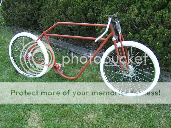

Well heres another Board Track Racer.
This project has been in the making for about 3 years now, I've had to take some time off from it at the momment for other obligations.
Time is running out for the "Winter Project" so.......take a look!

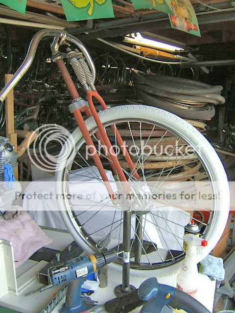

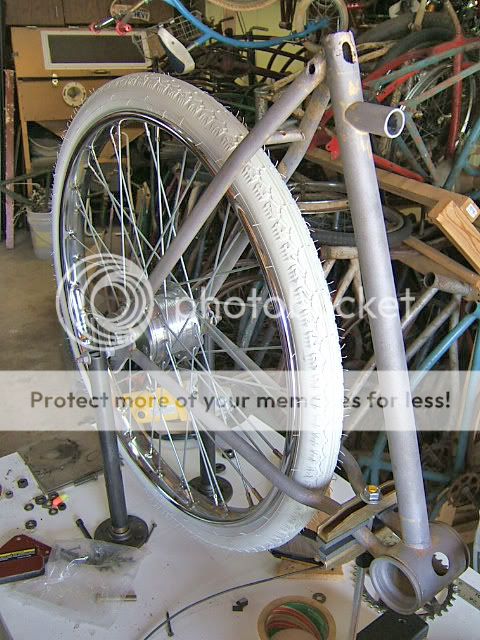

Life started out as a back half of a Pre War bicycle, it had the lines that I was looking for. Most of the early bicycles had a straight forward simple apperance. I had just the frame.

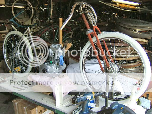

Next was to position the front end, its about a mile away from the back wheel. Actually 55", the wheels are Worksman 26" with drum brakes. The front forks are off a 1950's Monark bicycle, this was not a practical application for a Board Track Racer, but I like 'em

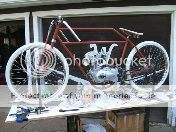

Heres what it looks like with the motor set up for fitting.
I'm using a 100cc Lifan with a manual 4 speed. The handlebars are for mock up, they will change in up comming photos.

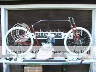

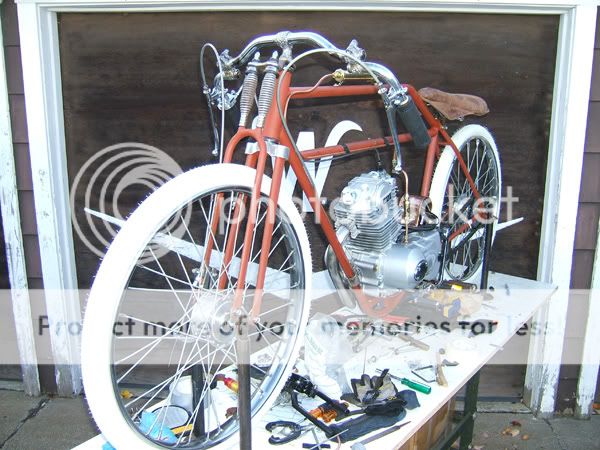

The top tube is installed, I'm using 1" DOM for the rest of the frame.
Bare bones rolling chassis.....
Heres a number of pictures to show how it has progressed.
more pictures to follow........soon!
