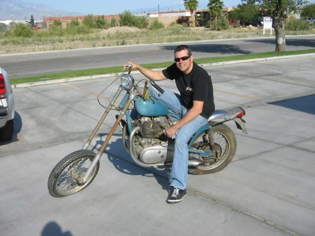

Mitch demanding a pose on the newly acquired project.

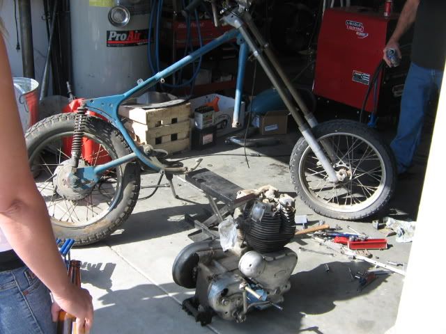

Quickly stripping the bike down to asses the amount of work ahead of me. I was WAY off.
First order of business was tearing the engine down, and getting it cleaned and rebuilt with fresh internals.
